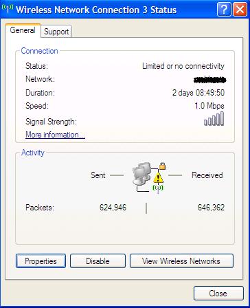

Normal:
The signal is weak and intermittent, it doesn’t even reach -90 dBm, which is very weak. If I get lucky, the connection is usually 1Mbps with signal strength 0-1% and sometimes no connectivity (I guess you understand my frustration). Very few signals are detected, and sometimes nothing at all.
Weak signal
