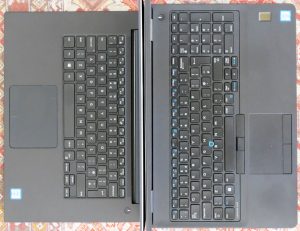

Dell Precision 5110 laptop vs. Dell Latitude E5570
The Dell Precision 5110 laptop on left and Latitude E5570 on right. The size difference is noticeable and, in this photo (taken in semi-sunlight), the 5110’s less effective anti-glare coating is evident.

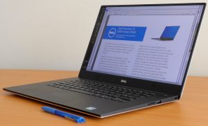

The Dell Precision 5510 laptop is available with either a QHD touchscreen or an FHD (1920 x 1080) resolution non-glare display. Research revealed that the QHD display resulted in significantly higher power consumption under light usage, I didn’t want a glossy touchscreen while I still have reservations about Windows’ display scaling. Consequently, I opted for the lower resolution display which Dell calls “Ultrasharp” and is in fact a Sharp SHP1453 LQ156M1 display panel. The panel has a similar brightness to the display used in the E5570 which is rated at 300 nits and is more than adequate for normal use. There is some visible backlight flicker at minimum and 10% brightness. I thought that the E5570’s display was very good but this Sharp display has better contrast and appears crisper (subjective comparison indicates less anti-glare coating than the E5570).
Dell Precision 5510 laptop screen
The color rendering of the Sharp display panel is slightly bluish but I have adjusted it using my Spyder 5 Express calibrator which revealed that the display covers 99% of sRGB / 79% of AdobeRGB, which is better than most notebook panels. The viewing angles are also very good.

Precision 5110 on left and Latitude E5570 on right highlights the differences in size and keyboard layout
Dell used the uncluttered approach for the 5510’s keyboard which has only 81 keys. It lacks the dedicated PgUp and PgDn keys above the left and right cursor key which Dell included in the Latitude business notebooks. The keyboard has less travel than the Latitude keyboard but this is easy to get used to.
