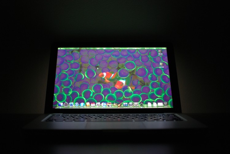

The screen on the MacBook Pro is average compared to other glossy panels, and has the downside of having the highly reflective glass layer over the LCD. This increases the amount of reflection from other objects, including you sitting right in front of the notebook. While you do adjust to it after a while, it can still be annoying. Pictures and movies look great thanks to the glossy surface and a healthy 60% bump in color gamut over the previous generation MacBook, which gives vibrant colors and deep blacks. Overall brightness is excellent for viewing in brightly lit rooms like in an office building or lecture hall. If you were able to find a spot of shade you could also use it outdoors as long as you find a strategic position away from any glare. Viewing angles are average for a TN-panel LCD, with colors starting to show signs of inversion when titled 20-25 degrees forward or back. Horizontal viewing angles are much better, with colors staying accurate at steep angles, right up until the point where reflections overpower screen.

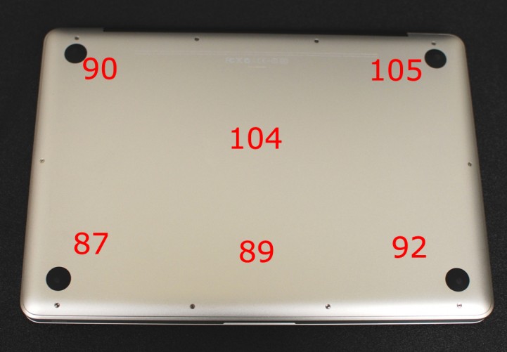

Heat output is always a touchy subject when it comes to the newer aluminum-body Apple notebooks. When under stress the entire system acts as one huge heatsink, making it very unfriendly for your lap in those conditions. Under normal daily activity the MacBook Pro stays relatively cool, shedding heat into the air quite well, keeping the body cool to the touch. Fan noise under these conditions is non-existent. One situation that warmed up the notebook considerably was installing Windows Vista through BootCamp. The back section of the notebook, bottom, and keyboard had recorded temperatures as high as 115F. Unlike warm plastic, the aluminum body was quick to transmit this excess heat to your hands or legs making things quite unpleasant. Thankfully it was only during the installation that we saw temperatures get that high, but if you were gaming for a few hours or encoding lots of video you might experience the same thing. Below are two temperature readings taken from the 13″ MacBook Pro during our tests. One shows how hot it can get while running Portal for 20 minutes, and the other shows what it is like under normal non-stressful conditions.
External temperatures after light use
External temperatures after heavy use
