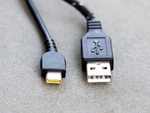

USB-C (left) compared to a traditiuonal USB-A (right).
USB-C (left) compared to a traditional USB-A (right).
USB Type-C is a new port connector, designed as a replacement for the existing USB Type-A – you know, the standard rectangular port we’ve been used to for almost 20 years. This new standard is considerably smaller, and can be inserted in either direction – there’s no such thing as upside-down.

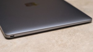

The 2015 Apple MacBook was the first widely available consumer notebook with a USB-C port.

On the opposite end of practicality is Apple’s MacBook (2016). Besides its headphone/microphone jack, it has just USB Type-C. This single port doubles as the power jack, so when plugged in, you can’t use the USB Type-C port. As we stated in our review, it’s a frustrating setup. To compound the issue, Apple’s USB Type-C adapters are expensive. Their USB Type-C to VGA Multiport Adapter is $79, a hub with USB Type-C input, full-size USB, and VGA. If you need Ethernet, that adapter will cost you $35. That’s a lot of money for a few ports. However, expensive USB Type-C adapters aren’t exclusive to Apple; we’ve yet to find any we’d term inexpensive.

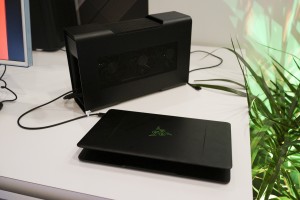

The Razer Blade Stealth uses a Thunderbolt 3 USB-C port as a connection for an external graphics solution.

The sole current application of USB Type-C that can’t be replicated by other ports is external graphics support. We previewed Razer’s Core at CES 2016, an external housing that fits a full-size desktop PCI-express graphics card. It connects via USB Type-C to Razer’s Blade Stealth Ultrabook, turning it into a fully-fledged gaming machine. This is a great application of USB Type-C, though be careful if you plan to use it for external graphics. The USB Type-C port also needs to support Thunderbolt 3 technology; USB 3.1 won’t cut it. Most USB Type-C implementations on notebooks and tablets today don’t have Thunderbolt 3 support, as some cost is required to implement it. Look closely at the specs of the device you’re interested in, or ask in our forums if you’re unsure whether a particular device has the support for Thunderbolt 3 or not.
